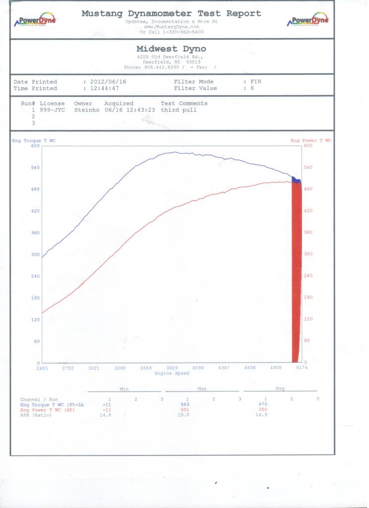

Here we go. Corrected on a Mustang Chassis dyno it made 501 rwhp and 583.9 torque.
First pull she was way rich so I let off at 4200.
Here is the 3rd pull after some tweaking to the maf transfer.
1986 ASCMclaren #108
stock E7 short block, explorer intake, 65mm TB, home built Gt45 turbo kit, 3.08s, Borla cat-back, '05 slot maf, Gt-40p heads, TFS1 cam, 80lb injectors, E85, Qaurterhorse tuner.

Not Worthy
Holy Crap Thats one powerful Capri/ASC
pictures of the engine ?
Need Pictures

MIke, congrats. Thats crazy horsepower. More than I could handle. Way, way way more.

Thanks Stan. It' really doesn't feel that fast to me.
I did turn the boost down to 9 psi though. I'm pretty sure this block has had about enough abuse, at least the bearings. So when I get the money and time I will start building up my other block and trans.
