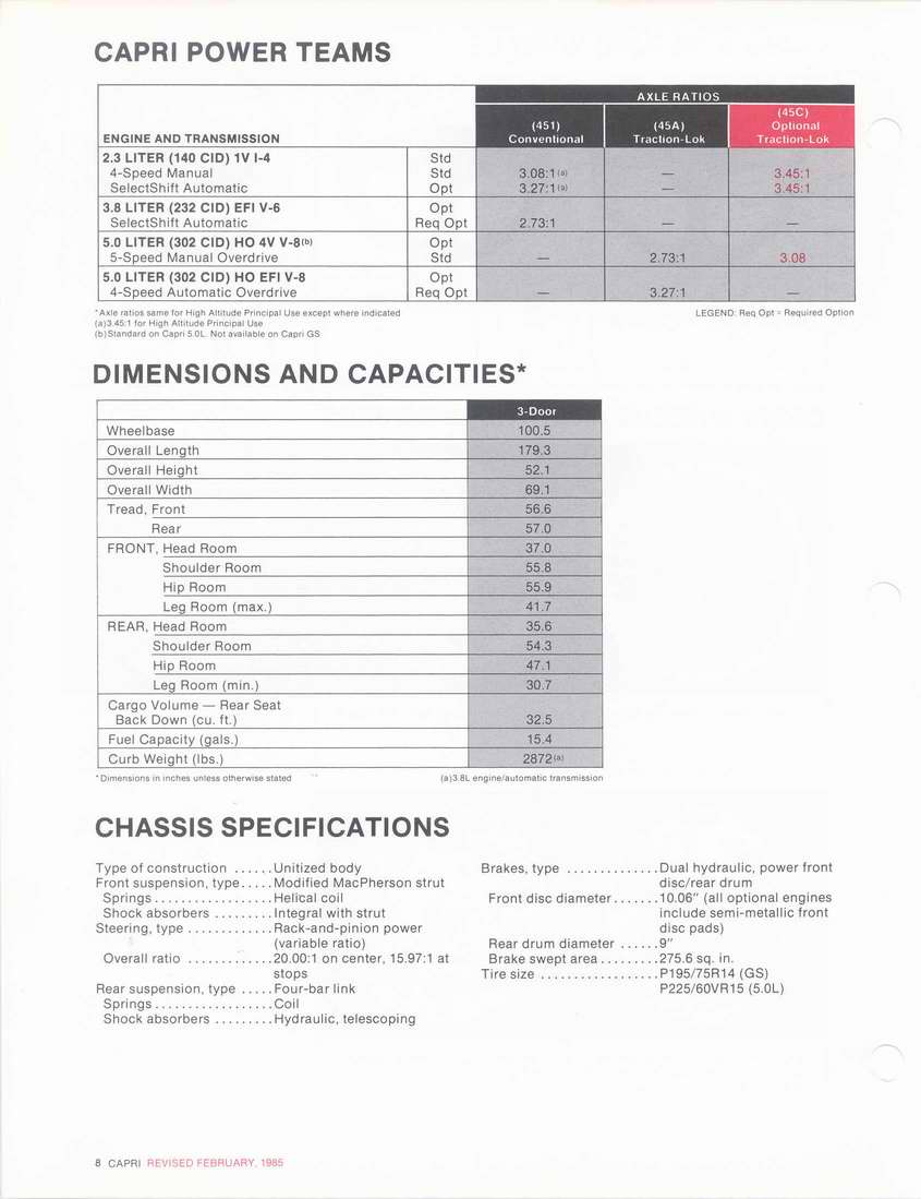

rescard wrote:Mike, this is great stuff! Thanks for showing me those brochures. It actually helps me out w/ interior ideas as well. Couple of other quick questions. First, you made no reference to the GS model(s). NHRA lists them but w/no details. Do you have info. on those as well? Secondly, many mid 80's Fords/Mercs had grey interior panels/plastic and dashs. I will print out the web site you referenced, but in the meantime, did Capri's have grey as well? Finally, on the hood scoops, I agree w/ ur assessment. My plan is to use the forced air induction as in the stock design, but I was wondering if, in addition, I should open the underneath of the scoop and have that assist drawing cool air. At 125mph or more, that could make a difference. What do you think? Ray
Well, for 84-86 the "GS" model was just the base Capri. The RS/5.0L added to it.
84-86 Capris could have grey interiors. 79-83 could have black. Reds/blues/tans and others were mixed around all the years.
I found the page on my site for 1985 curb weight: http://www.ascmclarencoupe.com/Literatu ... ook_10.jpg

Mike, the insight on the weights and interior is exactly what I needed. All the plastic and components inside are now stained/painted the original grey. I do believe that the 86 GS model is the Grand Prix version that uses the ASC components w/o any reference of that on the car.
